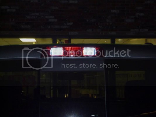

I have LED tail lights and 3rd brake light.
Here is how they look.
