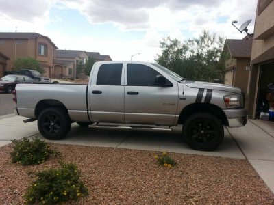

I hope you can see...i went with broad strip on mine

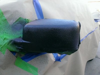

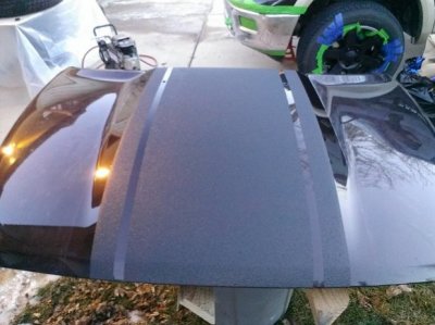

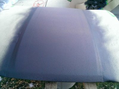

Someone recently hooked me up with a dent in my hood (beer bottle). Was just going to just repair the dent, but then I decided to try out the idea of bed liner racing stripes. While I was at it, I wanted to removed most of the chrome, but leave little highlights...Hit the hood, bumpers, grill assembly, mirrors and step bars. Playing with the idea of taking the stripe over the entire vehicle, but that roof is going to be a PITA!!!

epitomeofme: what did you do to the chrome prior to painting? I put bed liner on the grill insets and it does chip off! I thought it would be tougher - but I guess it has nothing to hold on too! Need more pic's?!!

So far everything has held...I did do a crapload of sanding...just the grill assembly alone, I spent about 4-5 hours sanding.
As I read and researched (over and over)...the surface prep was the key. I started with 80 grit one direction and then went back over with 120 the other direction. I did that several times. The idea I had was to make "cross-hatch" designs for the spray to adhere to. Not sure if that makes sense, but it made complete sense to me :) !!!!

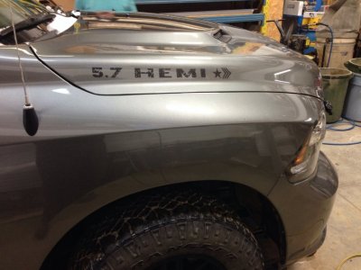

Here is a shot of the hood decal. Looks different as everywhere I look now people have the same colored sport :(
That is slick! Like that a lot.
