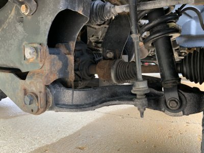

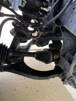

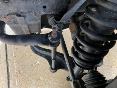

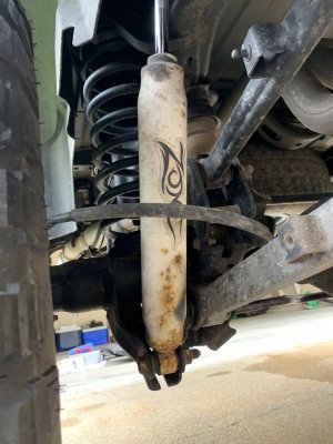

Ok it has to be a 4 inch then bc I have 35s on it and I know it’s not 6 inch. All I have is pictures until I can get someone to look at it and see what is needed. Sorry I’m not much help.

You have what looks like a zone 4" with the basic setup. Aka a spacer on top of stock shocks. If you're looking to add a bit of front height back to it, bilstein 5100s to replace the stock shocks would be an affordable upgrade.
In that case treat it the same as any other level kit, measure yoir differences, decide how much lift you want and set them to the best height setting. They are stock replacements so they'll plug right into yoir current lift.
