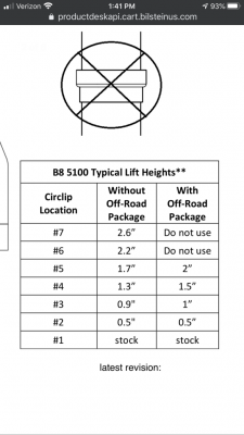

Avoid spacer lifts unless you're doing a bracket lift that will put the factory geometry back where it should go after doing a big top spacer (front diff drop, aftermarket steering hub that relocates your control arms mounting points, etc). If you're doing spacers then 1/2" at the top is safe. 2-3" spacers are BS in the 4th gen or 5th gen trucks. They're typically BS in any standard a-arm IFS application. companies advertising such spacers get away with such a scam because people are too cheap to pay $300-$500 to lift their $40k truck and choose to go with the $50 **** spacers or worst pay $300 for the shinny **** spacers ones because they're easy to install. Get adjustable struts instead or quick lift struts. they're safe to use and will allow your front end to cycle within it's operational range.
If you don't have ORP , set the 5100's at #6 for 2", this should level the front or #7 for 2.5" front, likely you'll need a small spacer in the back to give you a little rear rake.
If you have the ORP package your front and rear are lifted 1" more compared to non-ORP via coil springs. so if you want 2" in the front set your Bisteins at #3 for an extra 1" front,
#4 will put around 2.5" front and be flat level with the ORP 1" rear #5 will put you at 3" (i'd really think you'll net 2.5", maybe a tad more as the numbers from 1 through 4 are pretty much the same)) front, i'd think you'll want a small spacer in the back to gain a little rear rack.
Have fun.

@Nick@GotExhaust can set you you with Bilsteins they are the best bang for the buck to do your level
New to Ram and Forum as well. Wondering if 2" level kit will be too much in the front as I have the Off Road Package.
With your off road package bilstein max's out at 2" which is exactly where you'll want to be.

The 5100's are available now and are a great bang for the buck. If you want to wait until Jan 2021 and dont mind spending a little more the Eibach Pro kit should be available and is a better kit overall.
Have fun.
Thank for the information. That’s what I was looking for. I do have the ORP. Thanks again.
