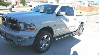

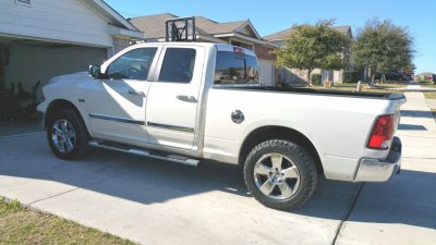

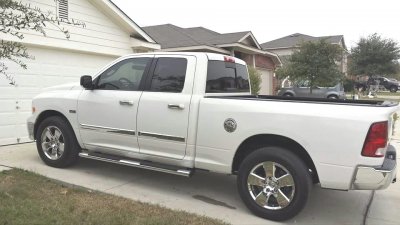

Okay. I finished both sides. The passenger went smooth as butter besides the tie rod in the knuckle. Had a friend come over with his fork bar thing and pry it loose, unfortunately he went through the boot so I'll have to look into replacing that. Afterwards though, the coil and spacer and everything went in easy with a little pry.
Question, daystar 2.5" spacers and es9000 shocks, will the eventually settle and drop a little?
I ask because the front sits about 1/4 inch higher than the back now, which itself isn't that noticeable, but with the rams hoods being so beefy, it looks higher than 1/4.
I didn't take pics on level ground as the only thing level by my house is the garage which didnt.give enough room to get a full shot. So I took before and afters on my driveway which is slightly sloped.
Here are the before (first bought) and after (today) photos.
