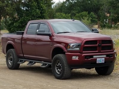

I have leveled 3 2500 trucks of my own using the Tuff Country 2" level kit with shock relocation bracket.
I put almost 100K miles on the first truck with the kit installed. No problems.
I only put 23K miles on the second truck with the kit installed. At that point it got totaled but again I had no problems.
I have the same kit on my third 2500 and am at 28K miles. No problems to report with it either.
