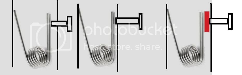

02-05 have torsion bar front suspension so they are the only ones that can have the torsion adjusters cranked up. Why people buy keys, I dont have an answer for that lol I guess some people just feel safer with them
The key just acts as a shim basically, the only advantage to them is they allow you to maintain the factory adjustability(not a big deal since you are adjusting them to where you want them lol)
heres a quick paint sketch to give you a better idea lol
The middle is stock, the left is adjusted and the right would be with a key
