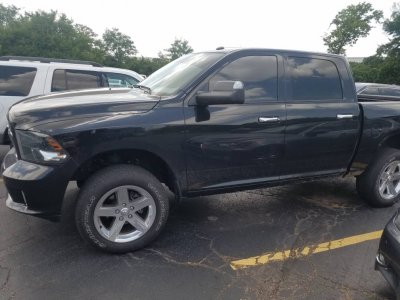

Mine is leveled 3" in the front 2" rear with the motofab kit. More of a lift now I guess but no issues and 20k plus miles and still rolling.20190708_144440.jpeg

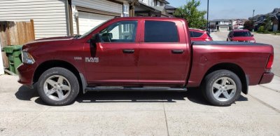

stay about 2 inches when leveling up front and you'll be ok. its going 2.5 inches plus (quite commonly here 2.8 that bilstein 5100s give) that can be the issue and hard on upper ball joints. that's why i went only 2.1 inches (effective 2 inches when checking after) with my new bilstein 5100s so i didn't have to worry about changing my upper control arms to accomodate a new geometry that could affect my ball joints. I think it's also going to depend what your driving plan is as well. my truck is a pavement queen. I think i could probably go 2.8 without issue. But I wanted to be as sure as i could be. Plus at 2.8 I would likely have had to have added a spacer on the back shocks to level. i am dead level now on my Ram... my driveway has an incline btw. i am 39 1/4" all around. only change was bilstein 5100s at 2.1 setting on the front and a wheel alignment after and its well within specs:

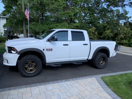

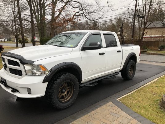

Bils at 2.8 with Air Lift 5000’s in the rear. No issues ever.
I did buy Zone UCA’s only cause I got them new for $200.
Here is the same as above with Zone 1.5 Body Lift added

Thank you! Just the Bilstein 5100s on front at the 2.1" setting I believe it is. I thought about adding spacers on the back but I rarely carry a heavy load in the back. She's a street queen. Still very happy with the Bilstein ride and handling. I've had a chance to drive on extreme winter conditions since installing. Still great. The installers said Billys are one of the few aftermarket options they have that rarely have problems in winter.
