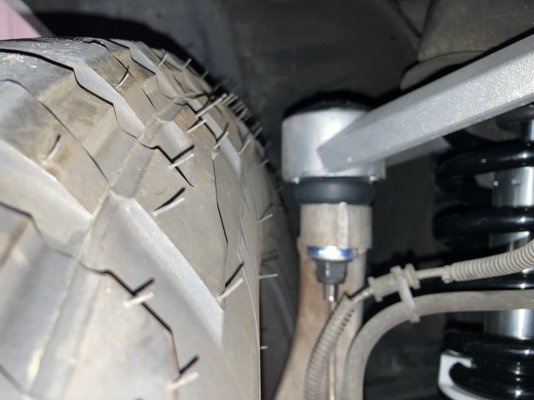

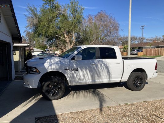

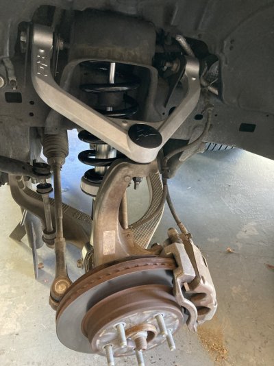

2017 Ram 1500 AWD stock rims with 275 60 20 wildpeak. 3in RC M1 struts and RC UCA. About a half in gap between tire and UCA. Should this gap be larger?
