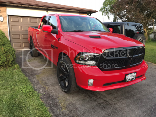

I have Bilstein 5100's on my truck. That is the best way to go for a leveling kits. Before and after picks.
