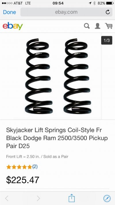

In that thread a forum member suggested the following 2.5" coils:

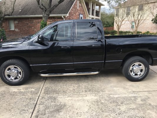

I want to simply level my truck. Do I need to do anything to the rear?
My truck:
Front:
Rear:
So basic math indicates nothing needed in the rear if front is 35" and rear is 38"? Am I considering enough? Will simply installing these front 2.5" coils, more or less, level my truck?

Ride rough because of the tighter coils?
They're for 2500-3500, they stiffer to accommodate the Cummins, you'll need longer struts as well, the first time the front suspension bottoms out it's going to blow the OEM length struts.
Edit: I scrolled up and saw you have a 2500, I though it was a 1500, you should be good on the ride. Are your coils over the struts?

Your truck does not have struts. You have shocks. You will want to get longer shocks for sure! You'll top those out and blow the seals in a week.
You could get away with shocks extenders if you're on a budget.
I don't want to scare you but leveling a 2500 truck can open a can of worms. You'll start finding out real quick what's worn.
Tires, you may need new, shocks, trackbar..

Hmm, wise counsel. Figured a couple more hundred for coils would be a good addition to the items I plan on replacing.
Here's what I'll be replacing for sure. Parts are either in my garage or on the way to the house.
On hand:
On the way:
Talking to a dealer earlier he recommended shocks there were at least: Extended length = 18.2" / Collapsed = 11.3" if I ran the 2.5" lift coils.
The shocks I have currently measure:
If I replace all the above mentioned parts, what else could be a problem down the road if I level?
Guess I'll look for some decent extended shocks if I go the leveling route.

Yes, I keep forgetting the HD's are not coil over, but yes, I would recommend a longer shock because you will over extend the factory length shock. You can probably get away with stock for a while if you don't want to do it now, but a shock that's a couple inches longer is ideal.
