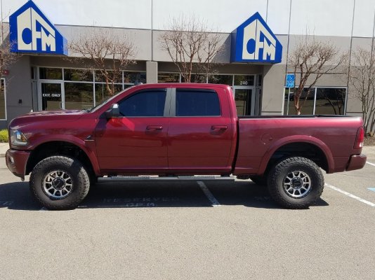

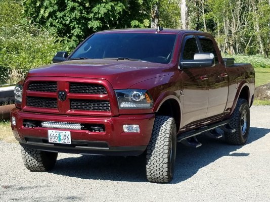

35x12.50R18 BFG KO2's on a 2017 Ram CTD. I have a 2.5" Tuff Country #32909 leveling kit and 18x9 medium offset (+12mm) Walker Evans Racing 504 wheels:
I had these same wheels and tires mounted on my 2014 Ram 2500 6.4L HEMI:
Everything fits fine, no rubbing at all.
