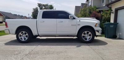

I really dont know what the benefit if the ranchos is aside from ease of installation. Im sure the OEM springs are superior, and I would go with Bilsteins all day over any other cheaper shocks.
I have Bils at 2.8, but I also added Rough Country UCAs to correct ball joint angle, and I added airlift airbags in the rear which give me an inch or so of boost in the rear at 15psi.
Ive ran alot of trucks but this setup rides very nice. A pic for rererence, I still have a little rake.

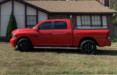

I know I am in the minority but I prefer the stock ride in my old age so with this one I just used a 1.5" small hole spacer and a Zone 1.5" BL that I removed from my last Ram when I installed a PA 3"BL. Looks good with 34" tires and rides great. I have had Bilsteins at a number of settings and Rancho's between the last 4 IFS Rams and like the ride of my present 17 the most . It actually absorbs the bumps in the road vs bouncing the truck . Much more work to get 3" total but I feel its the best ride I have had since the 03 with torsion bars and Bilstein shocks 3" BL with 12.50-35-17s. This combo is also easy on front end components as it only sees 1.5" increase .
Edit 1-16-2020
I swapped the 1.5 spacer for 5100's set at 1.4, $75.00 each ebay new. It rides smoother than the spacer and is 3/8" taller now. I sometimes drive the Red 2014 RCSB that was mine but now my daughter's and noticed that hers rode smoother than my 17 so I gave in an bought the Bilsteins again. I still don't care for billstein 5100's in the rear though on my RCSB's.

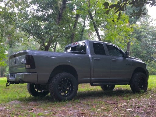

I have Bilsteins along with my 4” lift and I love them. Front rides better than stock even with a lift. Mine are set a 2.1”. 2c073154b85fef18daffd328daa04465.jpg
