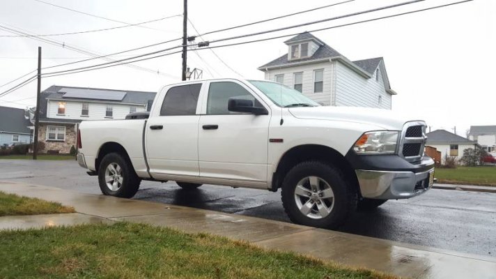

Hey guys new here! I have a 2015 Ram 1500 and im really trying to avoid a suspension lift but i want to get rid of the rake in it.. it had a 2.5 inch level when i bought it and i replaced that with a 3.5 inch level but its sits exactly the same. I just bought rancho quick struts and was going to buy ready lift upper control arms so i could stack the leveling pucks on top since the ready lift control arms support lifts up to 6 inches but i dont know if thats such a good idea! Help!

I'm gonna go out on a wild guess here and say you already have a suspension lift in that thing man. What's the measurement from the center of your rear wheel at the hub to the fender well?

You probably forgot about the rear being lifted. You are chasing yourself around in circle. No level in the world will get the front high enough to overcome the rear being lifted any. Look for a scaper or longer spring (likely a spacer) as for using a lift strut and spacer puck, thats a big no no

Theres only a 3.5" leveling kit in the front and as far as the rear goes i dont see on top or bottom a spacer... it has fox shocks in the rear which were on it when i bought it, would those make the difference? Everything done to the truck was done before i bought it.
Take a measurement from the center of the wheel to the top of the fender opening. I have a stock truck and can confirm what the number should be. It sure looks lifted in the rear. This is my truck with a 2.5 level and stock rear. 6750200b8a2fea8598b9c05175bece9f.jpg

So what should I look for? I know what spacer is supposed to go in the rear and I am not seeing one, only thing different in the rear is the fox shocks the previous owner installed.
The springs may be completely different and not have a spacer. Snap a few pics and take some measurements, from center of wheel to the the edge of fender. We're kinda flying blind until we have some info aside from the pic posted.

That truck was almost certainly lifted at some point, from what you are saying the used springs, not spacers for the rear. This is my '15 with a front level only.

So the front is 23" from center of wheel to fender edge and the rear is 26" from center of wheel to fender edge. Its 7" from top of tire to fender edge in front and 10" from top of tire to fender edge in rear.
Never thought about that being the issue i will look into that. I just assumed if there was a lift in the rear the guy would have used spacers in the rear as well.

My front and rear are both 24" center of wheel to fender. Previous owner installed a spacer on mine so I can't be 100% on size or brand but it's level. Your rear end is definitely lifted from stock. Can you get any pictures of your suspension?

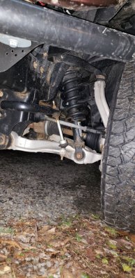

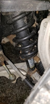

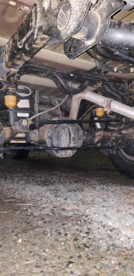

this was the best i could do as far as part numbers i couldnt find any except on struts in the front.

Rear looks OEM with Fox shocks, so that’s stock height. However, we REALLY need to see the upper portion of the rear springs. Use the flash on your camera or another light, as it’s hard to see in your pics. The front strut is definitely OEM as you can see the Pentastar logo. What we need to see is better pics of the top of the front struts/coils to see what kind of pucks/spacers you got up there.
