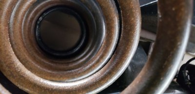

Get a picture of the top of the rear Spring- I will bet there is a spacer in there.

I’d bet a paycheck though he’s got at least a 2” coil spacer in back. He pulls that he’ll be more level, losing a bit of rake.

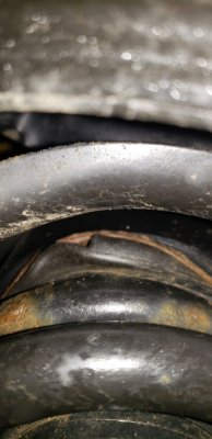

Rear looks OEM with Fox shocks, so that’s stock height. However, we REALLY need to see the upper portion of the rear springs. Use the flash on your camera or another light, as it’s hard to see in your pics. The front strut is definitely OEM as you can see the Pentastar logo. What we need to see is better pics of the top of the front struts/coils to see what kind of pucks/spacers you got up there.
So the front i cant get a good picture of the puck but they are from supreme suspensions and its a 3.5 inch leveling kit i know because i installed it. But there is a picture looking up inside the rear coil and a picture looking at the puck the best i can get.

As GIJoe stated I'd say you have a 2" spacer back there. If you're happy with the ride you have up front, your best bet is to pull the spacer and get it back onto the oem height. From there you can truly decide what, if any changes you want to make. There's tons of options out there. Eibach, bilstein, icon, sd truck, carli and I'm sure others all make coils for the rear and there's plenty more choices for the front. But you're gonna be chasing your tail trying to correct the front when the spacer size in the back would keep it level at 4" of lift.

Okay i will check for spacers in the rear next if there is any i will pull them and hopefully that will take care of that issue. Thank you guys for all the help if i need any more help i know where to go!
