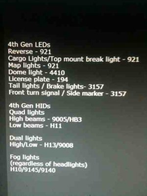

Those are for the 4th gen. I should have looked carefully before I posted. Sorry about that.....
