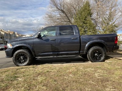

I have the vapors, not sure but I think there is a couple different onesED11898A-2142-4344-8A3B-B47311A0580E.jpeg

Thanks! Those look great! Your angle makes it easy to see how concave they are. Would that change with offset differences? What offset are yours? Also, how do you like the Ridge Grapplers? Those are one of the tires I am considering.
