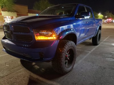

Like Goose I also have a 2wd crewcab lifted on the 7" lift kit. Kit has been great!
The cheapest on your wallet will be what goose mentioned. A 4.5" front with 3" rear. You can run up to 35" tires on this setup
On the 7" it will clear 37's however get the Maxtrac upper control arms! You'll need it with the biggest lift to allow the suspension to flex and articulate properly. If not the upper ball joints will die followed by the lowers and the tie rod ends. The weight of the 37's will also have an effect as well.
Good luck! Enjoy
