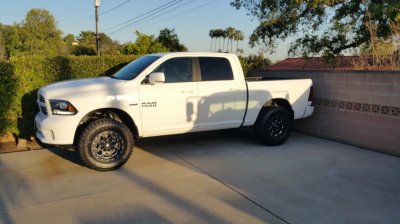

Here is my 2014 CC 2wd with a 4.5" Maxtrac spindle lift and 1.5" spacer in the rear and 35" tires. Everything fits good here with no rubbing so a combo like this would still allow you to change the bumper on yours no problem
