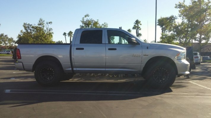

I have 315/70/17's here, which is pretty much a 35' tire, mounted on 17x9 wheels with -12 offset, with Rancho Quicklift, which is just 2" higher in the front with respect to stock, and Zone offroad UCA's, If this much gap in the fender wheels is what people refer to being stuffed, then i have to say i love the look :) and i'm not into BL's either. personal preference, im more into offroading and exploring the outdoors, i don't need anything higher than 2.5" honestly.
43677023305_50722520b9_h.jpg2018-09-09_09-10-11 by Wrangler RSM, on Flickr
44586847811_4968bbff96_h.jpg2018-09-09_09-10-00 by Wrangler RSM, on Flickr
Zero issues on or offroad
43520414145_6d80a6d19a_h.jpgUntitled by Wrangler RSM, on Flickr
30561801088_24511cfe7e_h.jpg20180902_105713 by Wrangler RSM, on Flickr

Yeah that's what most refer to when talking about "stuffed". There's nothing wrong with it, just a personal preference. Some like the most tire they can get in the wheelwell, some like more space showing. "Stuffed" is more like a tucked in, ****, modern, aggressive look, while "not stuffed" I guess lol is more of a lifted, older, traditional mudder look.
Both look good, just different strokes... ;)

Of course it is personal preference :) Nice pics, however I'd add a 4" lift and some fender flares. But that is my personal opinion ...

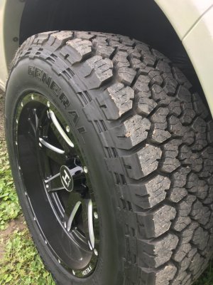

I went with 285/60/20 bils set a 2.1
I love the fit and the ride. Just a little over 33 inch tall general ATx E5C99656-BDC2-4F8B-A676-6737414AACE3.jpeg 909D130C-45E6-4F5B-B652-C9FA12FFA740.jpeg tires

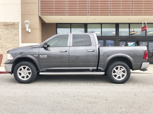

@cike
Bils 2.8 w/ 1.5 rear spacer
295/60r20 Cooper AT3 XLT.. 34.1 x 11.6
IMO it would have looked stuffed if I went with a taller tire.. it has the perfect amount of fender gap as it sits.

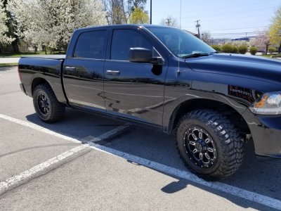

I have Cooper STT Pro in 295 70r18. They are about a 34.5" tire but I have them on 18 Gear Doninator wheels. I do have a small level on the truck and I dont rub at all on turns. I live in Pa so I get about the same weather as you do and I have not had a single issue offroad.

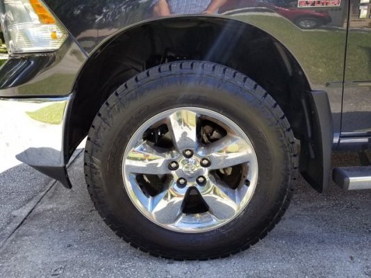

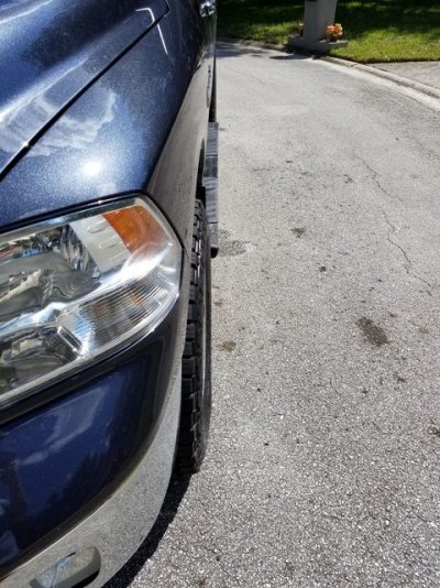

Got the Nitto's installed today - as mentioned before, I went with 35x11.50R20's. Thunderbolts out, of course :). Installer mentioned they balanced super easy, hardly any weight required. I chose the narrower 11.5 due to keeping stock 20x8" rims, plus keeps them tucked in reducing mud, dirt, gravel, etc getting thrown up on the sides, hopefully.
Rides great, hardly any noise or hum/drone. So far I'm pretty happy with them.

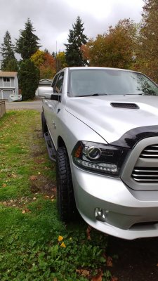

I've got bilsteins set at 2.8 with Cooper AT3 XLT 35X12.5X20. Wheels are 20x9 with 0 offset. I couldn't be happier with how it looks.
