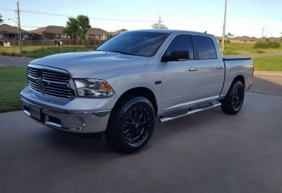

Bilsteins, and level. You can do 35's wit just a level.
Here is my 2015, leveled, with 285/65/20...basically 34.5" tall.
