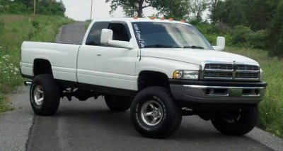

thinking about a lift. i want 35s. or bigger. i dont want to destroy my front axle or my transmission. ive got a 2002 2500 qcsb 4x4 that sits pretty high from factory. options are: hbs 2.5 leveling kit, zone offroad 5in, or just seeing if i can stuff 35s on... opinions? options? experiences?
