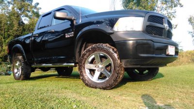

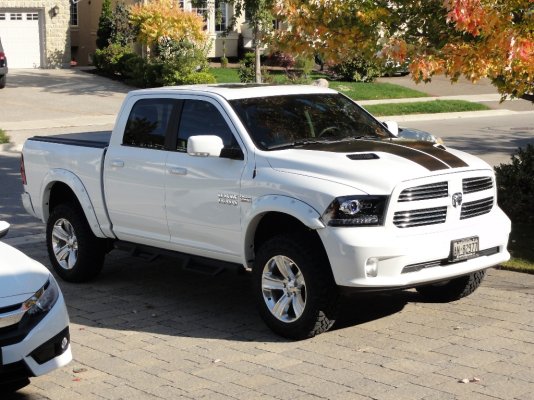

Great looking rigs guys.....and as someone else mentioned, I was also amazed at how good the stock Sport 20's look with a lift. I use them with stock width Duratracs for winter and was second guessing buying the Rockstars with 35's for my summer set.
Anyway, I've got 4" Superlift with 275-65-20 Duratracs and 1.5" Bora spacers.

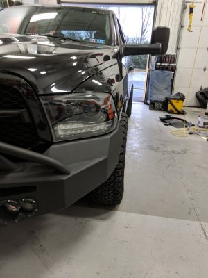

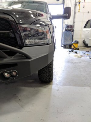

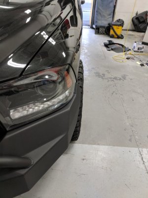

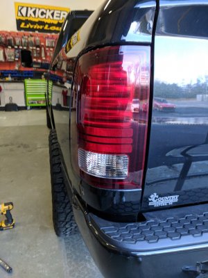

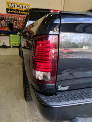

Hey bud love how your truck turned out. Would it be possible to get the front and rear wheelwell measurements from center to ground? Also how far do ur tires stick out from body?
Hey thanks man! In that picture tires are sticking out about 2.75". Rear fenders measure 44.5 and again, in this picture fronts are about 43.75. I ended up bumping the bils up to 2.8, and have different wheels now.
