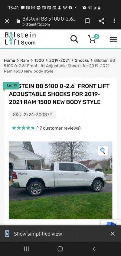

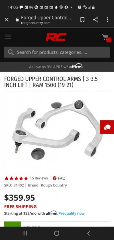

Thank you for the Awesome Info.! Per your Option 1 & 2, I Ordered the Bilstein B8 5100's Height Adjustable Shocks and the RC Forged Aluminum UCA's (see attached).
