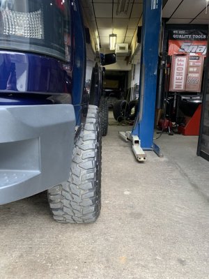

I just did a 3” spacer in the front and 2.5” spacer in the back and put 35’s on the factory wheels this weekend. I did put a 1/4” wheel spacer in the front just in case. It rides, drives, and looks great! The picture doesn’t to it justice.

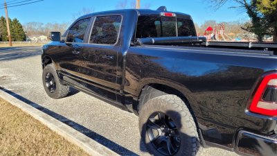

I put my Nitto Ridge Grapples on the stock rims, needing 1/4" spacer.(temp test fit). I had the RC 3.5" lift put on, I got less a lift then I thought.. I'm sitting level at 41", street to lower center fender (started 37"F 39"R). I have a set of 20"x10" on order to put on soon,
Fury 399 Gloss Black W/ Blue Tint. -24 offset. I'll put up some new pic when swapped out, til then here's my ride..

Truck looks great so far.

What the hell, did u paint your wheels black?!
Truck looks good!
