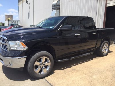

I just did the 4.5" Front & 1.5" Rear Maxtrac kit on my 2014. I had a similar opinion to yours thinking it wouldn't make too much of a difference. After the install I changed my mind. I'll easily be able to fit a set of 35s underneath it when the time comes. If I could go bigger and run 37s I would have bought the larger lift, however my truck has the dreaded 3.21 rear end with an 8 speed so 35s will be all I can turn.
If for some reason you wanted to lift it more after you got the 4" kit on you could always buy their springs and a new set of shocks, throw them on and rock it that way.
Good luck! And here's a pic of my truck with the lift I just put on

I also just did the Maxtrac 4.5" kit. It made a huge difference. You can always add 2" coils to make it a 6.5"-7" lift and then get the rear 3" coil kit. 4.5" was perfect for me and I can still fit in parking garages. In the group pic you can see me parked next to a truck that has the 4.5" spindles and my truck is stock.

Yeah I love it. I went in with the "I can always go bigger" mentality. When I finished the install I was happy with how it sat. Might bring up the rear a little to remove the negative rake but front height is right where I want it, and it'll still fit in my garage

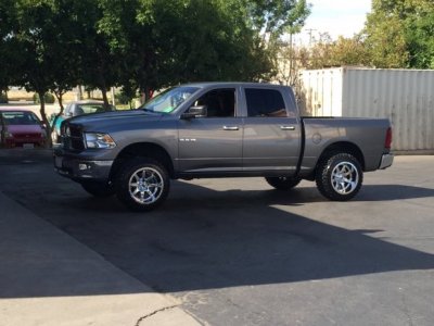

Found this pic on another topic, this is
front spindle, with a 2 inch level.
Rear is just the 1.5 spacer
SilverSurfer15
Feb 27, 2015
400
155
anymore of the black truck? trying to get ideas
Agreed, ive seen this truck on instagram, but I really want to know the specs on it. In some pictures it looks like 4.5 with 33s, and others it looks like 7 with 35s. Maybe hes had both.
Is he a member on here?
VegasDragger45
May 24, 2010
2,080
1,027
6.7
He's not a member it's my buddy AJ it's a 14 QC with 4.5" spindles and 1.5" spacers in the rear. He's running 22x14 wheels with 33x12.5x22 Atturo MT tires.
