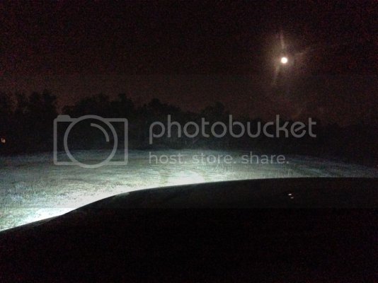

Just heads and fogs:
Heads and fogs ("high beams" on - cutout dropped):

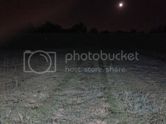

Heads, fogs, cutout dropped, with lightbar lights on:

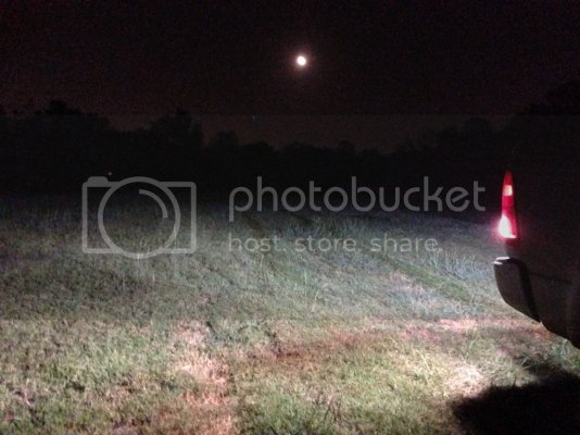

Reverse light action too:

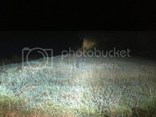

One more test from a different direction.

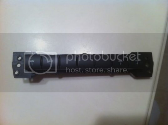

Everything is running through this switch now; I love it!
Without even running the lightbar lights, the output from just the heads and fogs with the cutout dropped is just stupid bright. I'm VERY impressed with the projectors and completely sold on them now.

Whatcha mean cut out dropped haha sorry I'm not sure what that means??
and how do ya like that auxiliary switch panel? i was thinking about getting one, how do ya wire up to it??

The projector has this cutoff, that's what gives the nice crisp line and keeps the HID bulb from scattering light everywhere. You click the high beams on (which triggers the cutoff to drop), and it scatters the light everywhere.
I love the switch panel. It's a little pricey (about $100), but well worth it IMO. The wiring is a little tricky, but very doable. Basically it's just like wiring a regular 3 pin switch, you just have to put the wires in a different order. Hit me up when you get it and are ready to install it. I'll walk you through it.
Sweet! can you just get it from a dealership? I've seen them online and stuff, i probably have to get that little switchboard thing or what ever your supposed to buy with it right? I like the idea of this alotttt better then drilling into my dash :killer:
You can probably get it from the dealer with the part number. I picked mine online. Here's what you'd need. The panel and the pigtail connector is all you need. The rest is just basic wiring and a couple standard relays.

Nice hmm interested on that aux switch too. Better than I wanted to do. Nice and clean looking that way. You need to share.
Morgan already did it, you can read up on this thread.
http://www.ramforum.com/f51/factory-switch-plate-13814/
I followed his thread.
