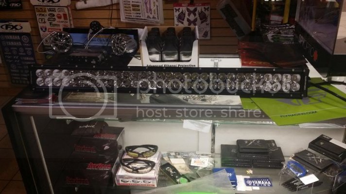

I am running a 30" led light bar inside my bumper. I did have to remove the tow hooks. And with it inside the cut out in my bumper it does protect it. I've already hit a deep and no damage. Lol.
And after hitting the deer with a brushguard installed also luckily.
And here it is before installed. A 30" CRE Led bar.

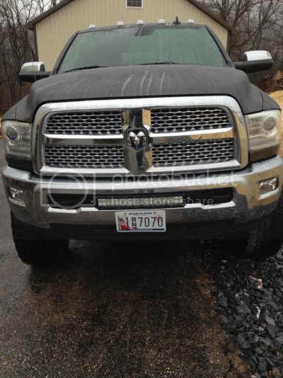

Here is mine...25" curved bar tow hooks still in place. IMG_22651_zps95c14df2.jpg
