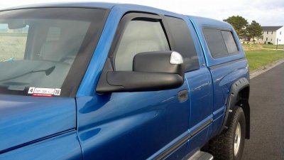

I got these for 1A auto. They are power/heated with signal/marker lights. I have had them on for a couple weeks and they work great. No vibrations. Brackets were included. I wired them up to use both turn signals and running lights. Not very bright during the day.

Nice!! 4th gen style on a 2nd gen. Real hard to not make an old truck look good. lol

Those look great. You had me fooled at first, thought you made 4th gen tow mirrors fit on your truck.

Wow, I didn't know they even made lighted ones!
I like those a lot more! Do you have any pics of them lit up at night?
Do you have a part # by chance?
