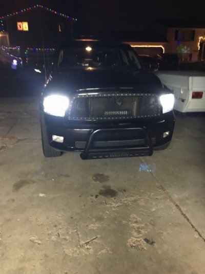

Go to Facebook and search auto led corp send them a message with your truck info and they will set you up with led bulbs I did my low beams and fog lights it around 280 but it's a tremendous upgrade to stock.
https://m.facebook.com/TheAutoLED/
