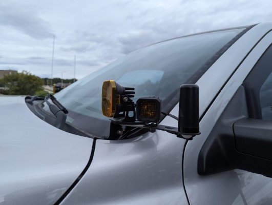

Why not both on the pillar mounts? Spot beams up higher will give you a little more potential distance than the grill. I have mine aimed to supplement the high beams.

Which brackets are those?
SDHQ out of Arizona, they go under the cowl so they aren't bolted to the hood and don't move. Then it's also SDHQ extender brackets designed for the Baja Designs Squadrons for the ditch lights. I had to drill the extender brackets out slightly for the Diode Dynamics bolt but they work great.

Those brackets appear to allow an optimal position for mounting of lights for visibility but do they create much wind noise at highway speeds?
None that I've heard from the lights or the antenna. Even during the summer with the windows down. But to be transparent, I never drive without the radio on so if it was a small noise I might be missing it.
