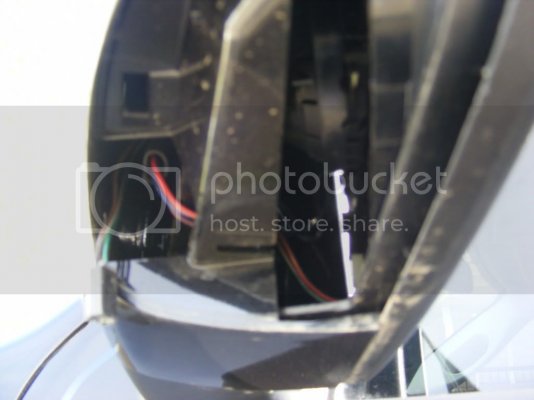

Here's the tab that that you need to release
view from under the drivers side mirror looking up:
Here's the slot the tab hooks into

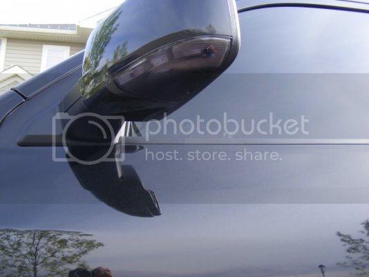

light shot of VHT tint
after...
