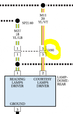

I recently upgraded my simple rear dome light (non-LED) to a push-button operated dome light (non-LED), and according to the schematics, it looks like a jumper needs to be installed on the I490 connector between pins 1 and 5. I have no idea where to find this connector. Right now the dome light can't be manually turned on while the car is running, and I suspect this jumper would provide the necessary power. I don't think any settings need to be changed with AlfaOBD.
Anyways, a means of being able to find this, and other connectors would be appreciated.
That connector is in the drivers side C pillar I believe?
