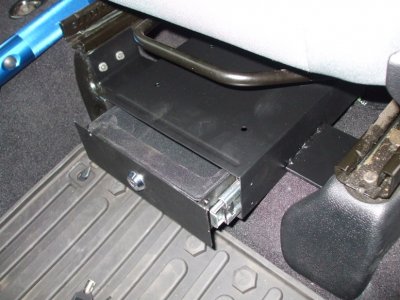

So I came up with what seems a good solution. I bought a Bulldog spring loaded vault with barrel lock. I figured an ideal place to install it was under the drivers seat thinking there was a ton of room under there.

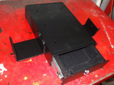

Well these metal connector brackets hogged up all the space. So I removed the brackets, disconnected the connectors from the clips and found sufficient space. I fabricated a couple of brackets using some channel stock I had kicking around and welded it to the outside of the box. You might be able to bold brackets to the box, but the space between the tracks and the inside of the box is slim, perhaps flatheads facing out??? I used the existing bracket holes and can return the truck to stock easily.
The best tip I can offer is to fab the brackets and bolt them on, then mark the vault box when it is placed properly.
A couple of tacks with the MIG to be sure it bolts up nice and then some better beads followed by a coat of paint and voila.
As for the connectors, I wrapped them with adhesive foam and simply pinned them between the carpet and the vault box. No rattles.
The seat moves fore and aft without any contact. The picture of it installed is with the seat in the full rearward position which I don't use but there is no reason it couldn't be moved in or out depending on the typical drivers seat position.
