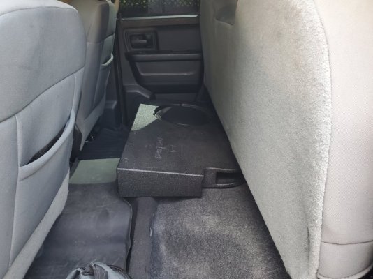

@Dean2 Great suggestion but I can't use the fold flat panels with the Fox Acoustics sub box, the seat already hits the box. I'm OK with fabbing up a plywood platform, just not sure how to anchor it. I've not been under the truck yet to see what's under the carpet in the flat spot under the seat.

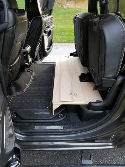

Makes sense. As far as anchoring a plywood version, just use the same attachment points as the factory fold flat floor. That way you aren't putting any new holes in your pickup.
This is a 2500 but similar idea.

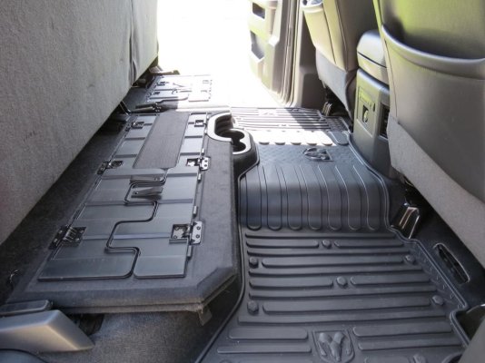

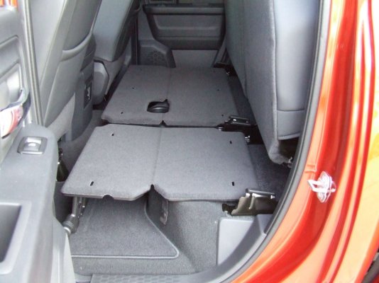

I don't think the Quad cab supports the fold out trays, the Crew Cab does.
I "think" they actually do mount up without issue, they just don't come that way from the factory as they limit seat positions (but so will a fridge!)...
Edit: Here you go...

Just measured my ARB 50 fridge at 20" tall, 15" wide and 27.8" deep. It's too deep to fit on the driver's side, hits the subwoofer box and needs another 4 inches. It's 1/2" too tall to fit under the tonneau cover in the bed too. Back to the drawing board.
