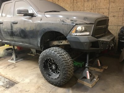

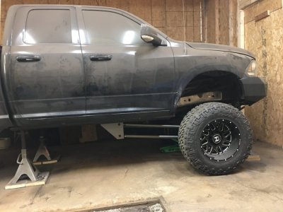

Thanks guys. A lot of work but worth it. Being able to adjust my arms by putting a wrench on the hex head to adjust it without jacking up the truck is a very nice feature.

Now I'm waiting for the pics of the torture test to see how well all your hard work and planning hold up.
That’s gonna be a while. Gotta install ram 2500 steering box, steering pump, and superduty transfercase.
Then weld a truss on the rear 10.5 sterling, and build arms and mounts for it. $$$
