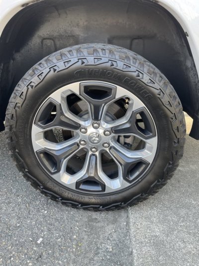

I’m currently running Terra Hunter 35x12.5 r22 tires on my truck at 77lbs a piece. I’m looking to see if anyone knows of a lighter tire in the same size?IMG_3800.jpeg

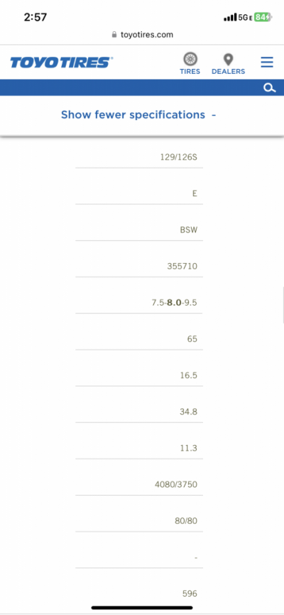

I have 18x9 on my truck. I’m looking at The toyo at3 in a 285/75r18 E rated. They’re 65lbs per. The 35/12.5 are actually shorter at 34.5” and weigh 66lbs but come D rated. The 285 being narrower and lighter should be a bit better overall on the highway but I’ll lose a bit off-road not going with the 305 or 35/12.5
