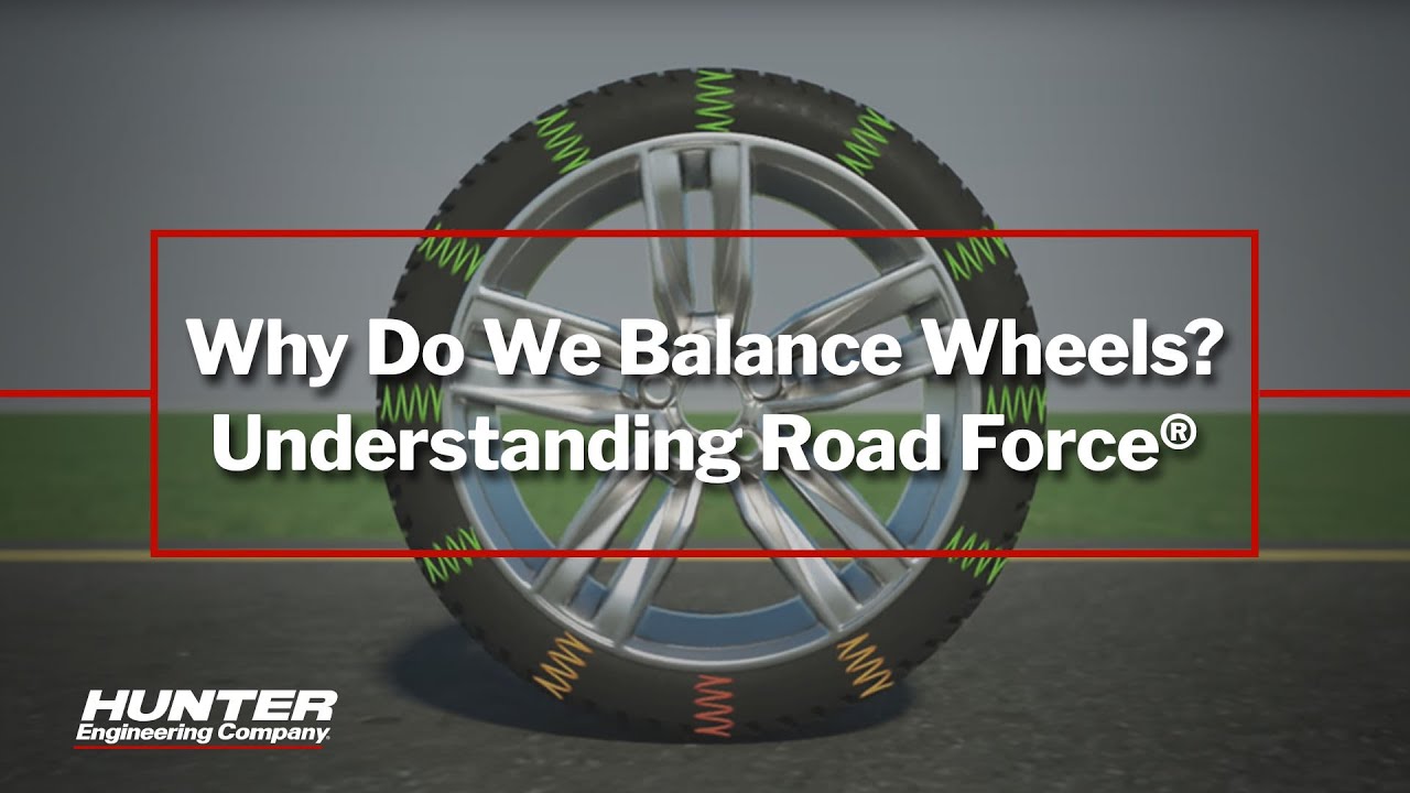

It's a process of matching the tire and the wheel (rim) to achieve a better balance (use fewer weights).
The Hunter balance machine does an initial balance spin and attempts to determine imblalance of the wheel balance, AND tire balance. The machine will provide a balance score. But the balance machine may (usually) suggest that by rotating the tire to a certain spot on the rim, a better balance score can be achieved. It's an estimate. Then the tire tech must remove the tire/wheel from the balancer, then put the tire back onto the tire changer, deflate & break the bead, and the specially-designed Hunter tire changer can rotate the wheel (rim) to align the chalk marks on each, per the balancer's previous suggestions. Then reinflate the tire & move it back over to the balancer and repeat the balance process. I've seen it halve the weights on tires. Sometimes the gains are minimal, usually they can be a lot. Definitely worth the effort IMO.
The balancer also has a rotating drum with a sensor which applies 1200# of force to the tire during the balance process to determine other possible tire issuues: out of roundness, broken cord, etc.
As you can see it's double the work for a tire tech, but the end result is it usually yields a better balance and a smoother running tire. And it catches tire build problems on the spot. Tires with the lowest balance score are usually located near the driver, and those tires with a little higher score further away from the driver.
Note: In contrast, a 'dumb' balancer will have no problem suggesting weights or a out-of-round tire. Then you'll be wondering where thata 'vibration' came from. Watch video below, and HERE. Truck tires are larger and can benefit a lot from cancelling whee/tire vibration. Tire/wheel vibration is the "root cause" of a lot of driveline failures.
