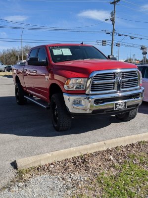

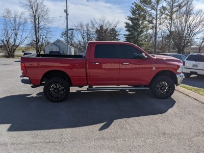

I pulled the trigger and upgraded from my 18 1500 Bighorn to a 2016 2500 Lonestar with the Cummins. Got the truck with only 61k on the odometer and it was deleted already with the four selection switch, a lift, and aftermarket rims. Got it with an all encompassing warranty that doesn't care about the delete for 44k out the door. Beautiful truck in red and loaded. Wife loves it too. What I'm looking for is information about the tune, etc... How do I find this information? There has to be some way to see what was done and what tune is being used, right?157955338_10158901390756897_7972460909437597678_o.jpg 157951066_10158901390686897_8554926084415154556_o.jpg

Congrats on the truck, looks beautiful. I agree with others, I wouldn't waste a penny on an aftermarket warranty. Those are sold to make money, not to provide a service to you.
That said, maybe post a picture of the selector switch to determine make/model of tuner.
