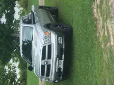

hey everyone I am looking for some help, I have just bought the diablosport i2 for my 12 ram 1500 outdoorsman, I am looking at getting a hemifever custom tune done, but for right now I am running a 91 octane tune, may go to the 93. I was wondering if anyone has went in and changed shift points or someone have a link to a custom tune you can do yourself that works. please help me out!! thanks!
