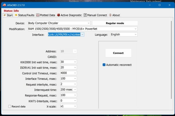

04fxdwgi
May 19, 2023
1,705
3,579
Coastal NE North Carolina
2016 1500 Sport
I haven't had problems with my '16 making those changes.
Perhaps it's your setup in AlfaOBD. The compatibility PDF shows what OBD dongles to use and which ones need the extra cables.
The pic shows how to set the type of OBD dongle being used.
Also, ensure you are hitting "connect" when you change modules to be tested. Very easy to be overlooked.
  • AlfaOBD compatibilty.pdf
