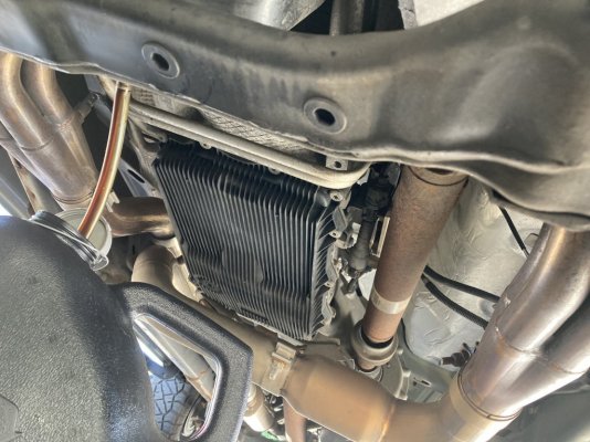

I’ve been very happy with the stainless works long tubes, had mine installed by Quick_Shifter, a member on this forum. I have to pass emissions so got y-pipe with hi-flow cats so can’t help with that, you will want to get a tune to get the most out of the headers

SW or ARH LTs
Hp Tuner and Custom tune is required not to get those pesky O2 codes :cool:
