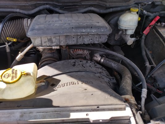

oil consumption is now over a quart in just over a week. no oil spots after I park and no oil smell while driving, strangely there are some droplets splashed on the fan cover and bottom half of the intake, I touched the spots and they looked like and felt like they could have been very fresh oil

What does your exhaust pipe look like ?
How is the bottom of the truck look ?

Check around your harmonic balancer the front timing cover seal see if its wet.

Another thing to note If the valve stem seals are orig and have never been replaced it 100% burns oil the 2 main failueres on 4.7 engines timing chains/guides And valve stem seals they harden up every single one will need it done at some point.

I've been tracking this as best I can, given logistics but I miscalculated in my initial post, it's more like 1.5 quarts every 2,000 mi or thereabouts. everything seems dry including under the hood
