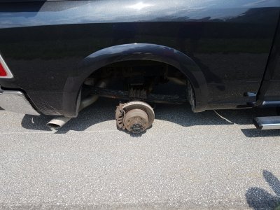

Anyone ever have this happen or ever hear of it happening? This past Monday on my way back from the campsite with my 13 K fifth wheel attached my rear right tire on my 2014 3500 truck decided it didn't want to go home with us. It sheared all 8 studs off at 100 km/h (60 mph) to say the least the nest 600 yards or so were interesting. There was no warning or wobble/vibration before hand, just the truck dropped and the tire was gone. All in all the truck handled really well.
Just trying to figure out if this is an isolated incident or is there a problem with the studs?

When was last time tires were changed or rotated?

The tire was installed 6000 kms ago about 3800 miles. (1 year ago). I know I don't drive it much. The truck isn't modified in any way. all stock.

I'm with the guys saying "Not Torqued". I watch when they put my wheels back on. Most shops install with an impact wrench turned down with low pressure so not to warp a rim. Then, they go back and torque. I bet they missed that second step on the OP's truck.

I'd take a few minutes and check the other three.
The Truck is at RAM and they are removing all three of the other wheel to have a look a the studs then re-install and torque. while they do the repairs

Happened to me about a year ago. Didn't re-torque my lugs. Probably 2000 km after I had them off. Thought I had a flat until my wheel passed me on the highway. Had to crawl into the bush in the snow to get it.

An idiot at my discount torqued my passenger side tires to 230 ft lbs. Obviously only used an impact. The guy that did the driver's side used a torque wrench and did it properly.

Or.....They over tightened them, which is much more common.
I have had studs break on my big rig due to idiots with air wrenches.
There is a torque spec for a reason.
This is common. Shops (even some bad dealers) will just use an air tool and hammer them on until they are way over spec. With the HDs especially I would also check the torque again after about a week of driving. I think Ram even recommends this.
