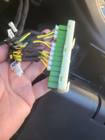

Sounds like a bad CAN Buss or bad CAN Buss Star Connector. There are several, and they act as a communications bridge between the various computer modules in your truck.
