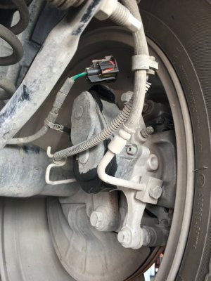

My truck was towed, and Nyle Maxwell found that the other caliper went bad! This caliber failure was different from the other caliber that failed in my other back wheel a month previous. On this wheel, brake fluid saturated the electric actuator, and caused the electric wiring to short out, causing my caliber to lock up. So now, they are going to replace my pads, caliper, electric actuator, and wiring!
This will be the 3rd set of pads, and both back calipers replaced on this truck in a year!

Is there any fluid leaking or signs of a leak? That seems odd... you don’t have any enemies do ya?
