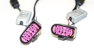

I got the wire moved from pin 3 to pin 1, so hopefully that fixes it. I contacted the vendor on ebay and explained the issue I ran into. He offered to send another set of adapter harnesses or give me a 50% discount/refund if I wanted to fix them myself. I chose the discount.
I will say, I had a heck of a time getting the wire moved. Taking this connector apart was a pain and resulted in mild damage and mucho frustration. But, I finally got it. Maybe I'll get the lights installed today, but still a little under the weather. (The last week has been rough).
Bottom line, I got what I paid for. But at least I'll only end up with about $35 in the harnesses. If I ever have trouble with the large connectors/pins , it's a 1J0973737 connector which appears very common on Audi/VW cars. If the resistors for turn signals burn out, I can remove them and set front turn signals to LED with Alfa. As far as I can tell, I could make my own conversion harnesses without any kind of special components other than the specific connectors needed. But when I looked into that option, the cost wasn't that far off from ebay ones, which is why I went that route.
Thanks for the responses. I'll eventually get em put back in to verify operation.

Weather was nice yesterday afternoon and I was feeling better, so I finally installed the headlights and newly modified adapter harnesses. Somehow, the stock 9005 high beam bulbs escaped, so they got replaced with modified 9011s. :emotions33:
The low beam shutters work now, so I can't wait to see the difference at night. Should be amazing...
