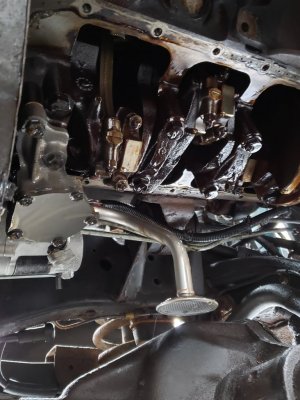

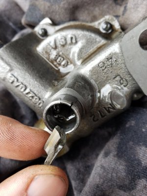

**Update**
So after installing new pump and oil pressure switch and still not having any pressure, I almost decided to take on the task of removing the distributor to inspect it. that would have been a pain in the ass because of where its located behind the block. before I jumped into that I decided dropping the pan and seeing if maybe the oil pump pickup was maybe flush with the bottom of the pan or something and not picking up oil. so I took off oil pump and it was a good thing I did. the sleeve on the NEW pump I had just installed was shattered..maybe I didnt install it flush, and the shaft wasnt lined up. but i put anotherrrr pump in and I have full pressure! hallelujah!
