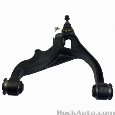

I have a 2014 2wd 1500 with coil springs and need new lower control arm ball joints. I know I will need to grind/chisel out the nubs to be able to press out the ball joints. What I haven’t been able to find is a part number for the replacement ball joint. I just see a lot of numbers tossed around but nothing seems to be truly confirmed. I’m not brand picky but need to get the right part on the first try since my truck can’t be down for an extended period of time. Thanks.

Air suspension? 1500? Check your upper ball joints too. They wear out too.
Note: For $102 a guy can buy Moog cast iron control arms with new ball joints

No air suspension. Regular old school coil springs so I am blessed with the LCAs that are twice the price as the others.

There's another ball joint post just a couple days ago (further down the main pg). Scroll down or a page or two and you should see. The guy bought Moog ball joints and replaced them. I think the model # was in his post. But yeah, make sure they *need* to be replaces as Hagar said above.
Upper ball joints seem to wear first. Make sure you check them too.
