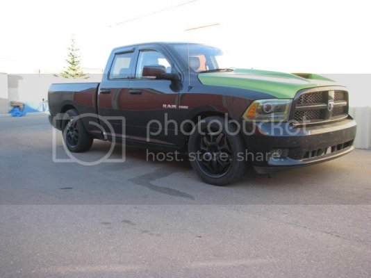

do you have pics of your truck? I want to see how much gap you have. Are you running 22's?
This is right after the swap before the spings have settled. They've dropped about another 3/8" and you can see the rear is a little high, that's because of it resting on the bump stops. With the bump stop removed I'm sitting +- 1/4" from 32" ground to inner fender.
the rig looks good. i see you used projectors in the fogs.
